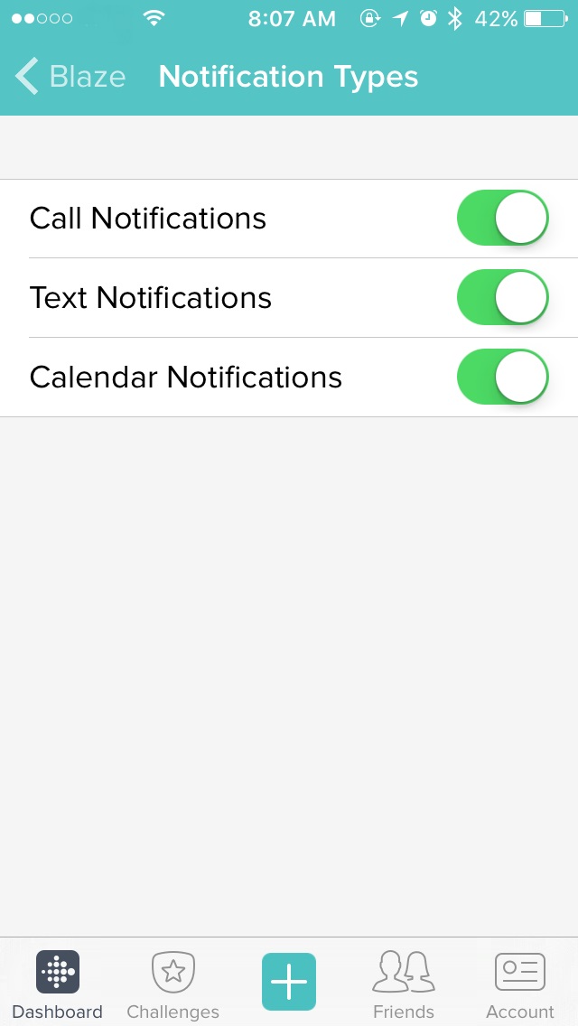

Hi there @Sterlingmike. Good to see you in the Community! 🙂
I would recommend first of all, checking that you have the notifications enabled on your app not just for calls but also for text messages and calendar notifications if you ever need them. For that, make sure you have the latest Fitbit app version installed and then, go to your app. Tap on your tracker which will bring the tracker settings menu. Here, tap on "Notifications" and then make sure that the notifications you want to receive are checked as you can see below:
If this doesn't work, try to restart your tracker by pressing and holding the left and lower right buttons for 10-15 seconds until your tracker reboots and then make sure to sync your tracker or even try to set it up as a new device by going to the Account section, choosing "Set up a new device" and following the on-screen instructions.
Hope this gets you back on track and let me know if you need more help with this!
