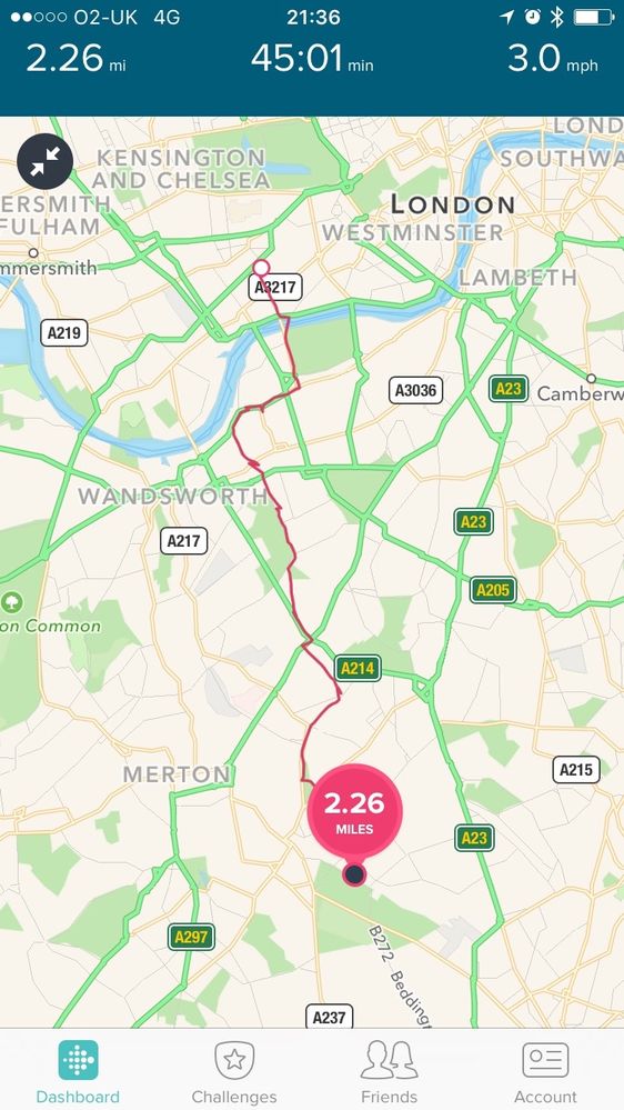

I regularly cycle to work, and have used RunKeeper in the past to track my activity. My journey is roughly 7.8 miles, as measured in Google Earth and in Runkeeper when creating a route.
Today I used my shiny new Blaze with connected GPS facility, only for it to tell me I had cycled 2.55 miles this morning and 2.26 miles on the way home. I have all location services and permissions set as they should be, and bluetooth sharing is on. My iPhone 6 is close to the Blaze.
On the way home I used both Blaze and Runkeeper as a comparison just to check my phone GPS wasn't acting up, and I got these results. The fitbit GPS functionality looks like it's not working quite like it should.
Runkeeper: 7.79 miles (pm only)
Fitbit Blaze: 2.55 miles (am) and 2.26 miles (pm)
Any suggestions or work-arounds would be helpful, don't really want to be taking the Blaze back to the shop.

I can agree with what you say, like you I am using a Blaze and cycling to work, the route is 5 miles with Map my Ride but I get anything from 2 to 5 from the fitbit. I dug a bit into the data and it looks like the fitbit is stopping tracking when the GPS signal is lost and restarting when the signal is re-aquired and ignoring the bit in the middle. However it still draws the line on the map. Most tracking apps will draw a straight line from signal loss to re_aquire and assume (quite rightly) you have done that bit. If you look at the graphs on the dashboard and set the axis from distance to time you may see sections showing 0 speed when you know you were moving. Fitbit I think you need a software change to the tracking to allow for GPS signal loss it is unrealistic to expect a perfect GPS signal all the time.
