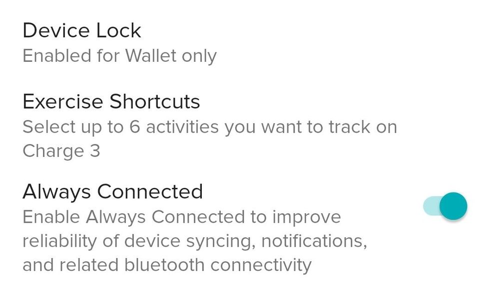

Is always connected enabled? If always connected is disabled, then you are correct. Your app still only connect when it needs to. Screenshot_20190603-143419_Fitbit.jpg
