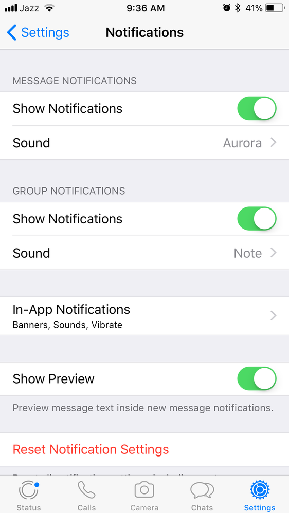

Best Answer12-05-2017 20:37
12-05-2017 20:37
Furthermore after checking ios settings check your settings for whatsapp.
Notification settings in Whatsapp app itself
