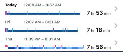

The first night I had the Charge 5, it seemed to track fine with Awake/REM/Light/Deep stages. The next two nights, no sleep stages, just Sleep Quality (fall/asleep/awake/restless/awake restless).
Any idea what happened?? I am wearing it snugly, a finger width above the wrist bone on my non-dominant arm, and I have never gotten it wet. It's well-charged. I have restarted it many times via the device itself and the 3 taps on the charger cord, force closed the app, synced with the device many times, and restarted the phone. Yes, it has been updated, also.
I bought this solely for sleep tracking and I am about to return it if I can't figure this out soon. Help!

I just saw your message in a different thread.  Yes, the solution to your problem is not to start the sleep yourself from the App.  That was there for older style trackers that didn't have heart rate tracking.
With the Charge 5 and other trackers that track your heart rate, they automatically detect when you're asleep by your heart rate slowing down and you not moving.  I've found mine to be pretty accurate but doesn't measure sleep stages if I had a very bad night and was awake a lot.
The best way to get your sleep stages is to just go to bed wearing your Charge 5.  Don't set anything, just let it do its own thing.  That seems to work well for me.

Thanks, Wibby. Forgot to update my own thread! lol. Yeah, chat person said the same thing. How ODD though that Begin Sleep Now means you are telling it NOT to track sleep stages? You'd think it would tell you this?? Also, I swear I said Begin Sleep Now all three nights and it only collected them the first night, but not the last two. But I will try that more intentionally tonight and see if that helps.
