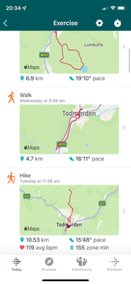

Hi, I’ve suddenly lost the average BPM from my activities. I’ve not done anything different. I’ve tried turning the phone off and on (I’m on an iPhone 11). It’s seem that my heart rate has been monitored as it looks like it’s there on the online dashboard just not in the app. I would put up a screen shot but can’t find an option for that.
Any thoughts? It worked up until 2 days ago. Thanks.

Hi, it is showing there. It’s missing from activities. It was there until my walk yesterday and today. It shows for a later short one I did today which it recorded automatically. I can see it elsewhere in the app it’s just not pulled through to the walks.

Hmm nothing is bringing this back. Done a hard reset. Have deleted and reinstalled app. I can either let it record automatically and get heart rate but no map, or start an activity, get the map but no heart rate. Very frustrating 😔

Well, it seems I can no longer start my walks from in app, if I do that I will only get GPS. I now have to start all activities from the shortcuts on the device, only I can’t fit all my activities in to the shortcuts, so means changing the shortcuts from time to time. Kinda annoying but at least problem solved.
