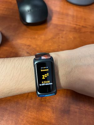

I’ve attached a picture that was taken around 1:00pm with the weird amount of snooze time to give you an idea of what it’s showing me
so for some reason, either when I tap “snooze” or when it automatically snoozed, it’s laying on a ridiculous snooze time instead of the typical 9 minutes.
I’m wondering if this affects the other alarms and maybe prevents them from playing?

I guess you really did mean 1500 minutes. I figured you must have meant 15 minutes, 0 seconds, like 15:00. I have no idea what's going on then.
