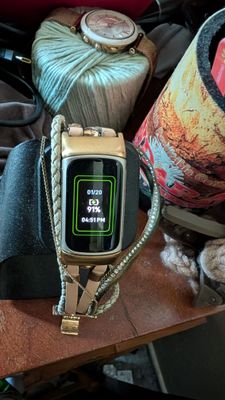

At work, I am not allowed to carry my phone but require watch/time keeping device.
Charge 5 consistently stops working part way through the day. Today it was 11.15am. It will restart with the charger, but I shouldn't need that part way through the day.
When I put watch on charger this afternoon, it showed close to 90% charge.

Hi there, @Mich14. Welcome to the Fitbit Community Forums. Thanks for bringing this to my attention and for the image attached. I'm sorry to hear that your Charge 5 keeps turning itself off. I will do my best to help you with this!
If you haven't done so yet, please try the steps below:
If the above doesn't work, please restart your Fitbit device once again as suggested here How do I restart my Fitbit device? Note: Restarting the device doesn’t delete any data. If the restart doesn't work try to change your clock face. If this fixes the issue, you can change your clock face back to the original clock face.
