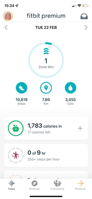

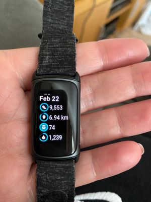

I have a tile for Zone minutes on my phone but it’s only showing 1 for that day which added after I’d restarted the app & my Fitbit (I attached photos of my app and Fitbit showing the discrepancies)
No exercise is showing for that day either 😐
have tried all the steps you suggested, today and when I had the issue on Tuesday, but it’s not rectified the problem.
Thanks for the help 👍🏻
