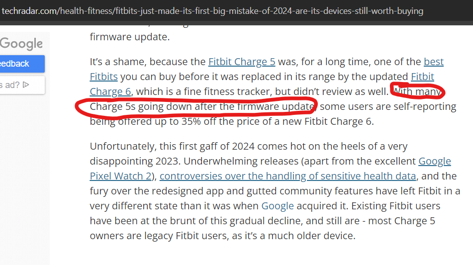

Nothing to do.
We have said many times here that Fitbit is not giving solutions. Fitbit wants "Charge 5" to die. It's easy find news like that:
