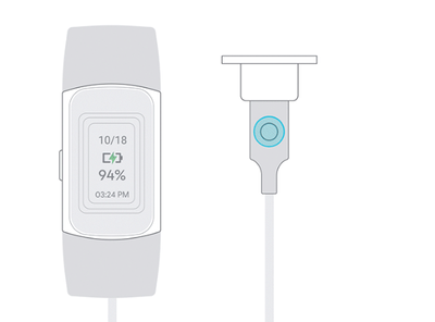

There is no button on the charging cable to try a reset.  What are me options?

In order to restart your device, you'll need to:
  1. Connect your device to the charging cable.
  2. Press the button located on the flat end of the charger 3 times with one-second pause between each press. Then wait 10 seconds or until the Fitbit logo appears.
(The circle shows the position of the button).
Another way to restart your device is to unplug it, wait a second, and plug it back in. Repeat this process 3 times in an 8 seconds interval, and then wait 10 seconds until the device restarts.
