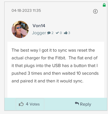

Hi Marre, I am having similar problems reported by PCarrabin. Charge 5 had not reset itself overnight (still counting yesterday’s steps), updated mobile app to Fitbit 4.35 this morning but Fitbit Charge 5 and phone now do not/will not pair, despite following steps you outline above. I used the same link provided to PCarrabin to report this directly to you.
Best AnswerUpdate - I retried the pairing but followed the description of steps by Von14 on April 18, 2023-see below. My charge 5 is now paired with my phone. But there is still an issue as my daily steps for today on my phone and my charge 5 do not agree. The mobile app includes yesterday’s steps as well.
