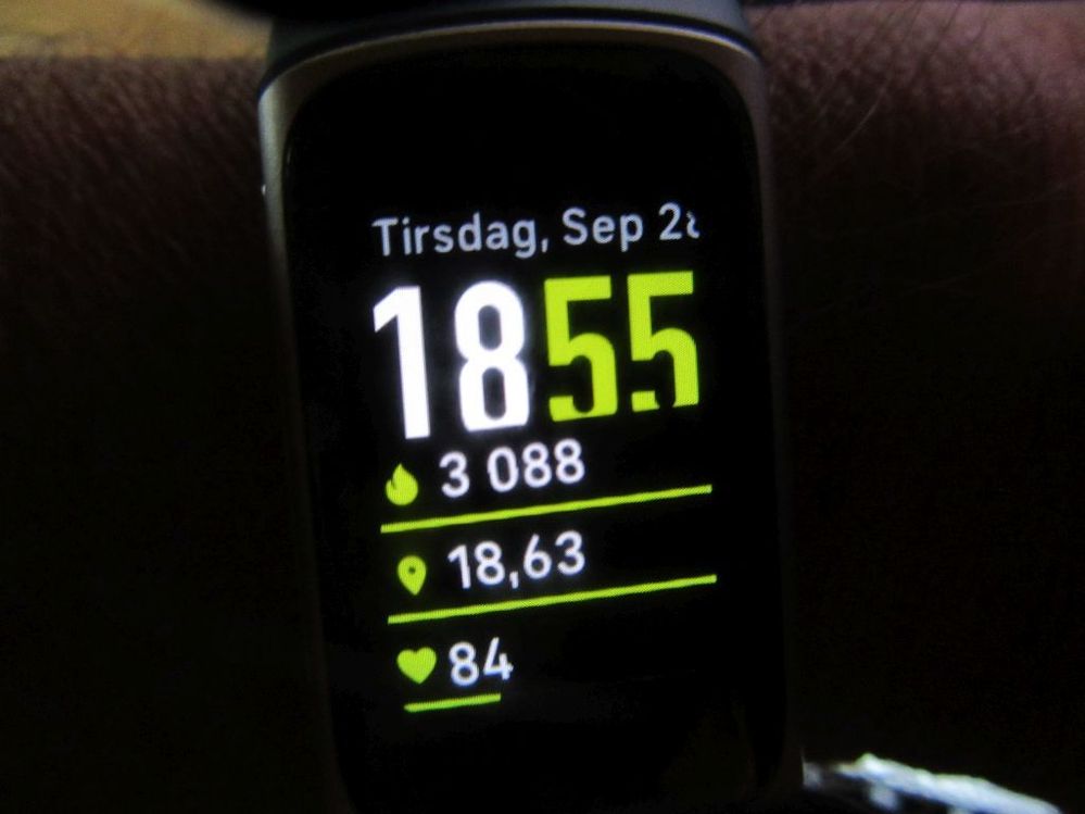

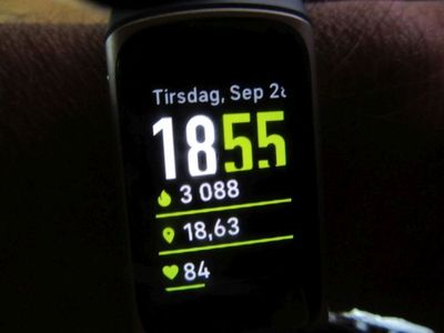

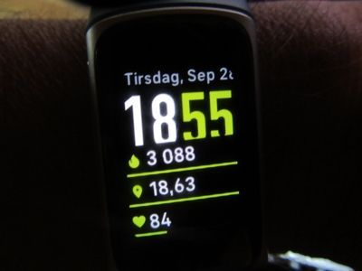

The "Slashed" clock face, my initial choice, has Mon, JAN 01 showing up in the app picture on top of the display. In my Norwegian language set up Charge 5 it reads Tirsdag, Sep 2. Problem is that there is not enough space on display so the actual day date can't be viewed. This seems to be the case for other clock faces as well with the same top-line look ("Retro", "Energy", "Target", "Ripple", and "Progressive".
Have high hopes that this issue can be fixed relatively easy 🙂

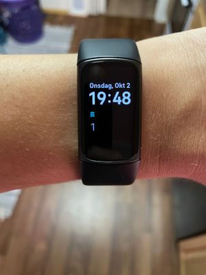

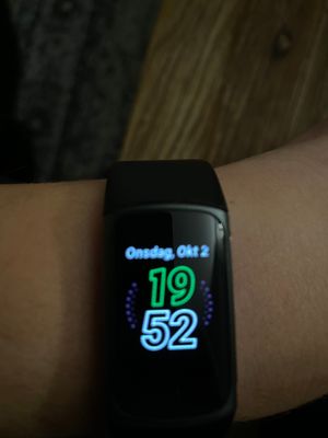

@DavideFitbit it seems like the day is spelled out in it's full name in Norwegian. For example Wednesday is shown as "Onsdag" which is correct but according to the example screenshots for the watchfaces they only show "wed" , the first 3 letters when it is in English. So it should be "Ons" in Norwegian. Having the full name seems to push the date out of the picture. Would be nice to have this bug fixed, makes date unusable

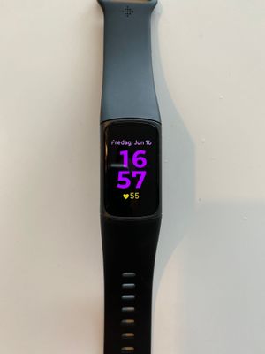

The last digit of the date is clipped.
Date is in reality written as "07", but only the first digit is visible. In other watch faces i can see a small slice of the last digit.
Screenshots from watch face section in app shows that day names are shortened, but on my Charge 5 it is displayed in full. Guessing that is related to this issue somehow.

That’s exactly how my Fitbit charge 5 displayed the date Wednesday June 05.
