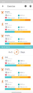

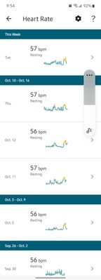

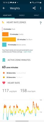

When I track workouts, it does record heart rate and shows the heart rate trend. The app also syncs all the other metrics like steps, calories, and even Zone Mins. It just does not track heart rate and hasn't for a week now. It would just start doing it all of a sudden, after doing a whole song and dance of resetting, rebooting, restarting a bunch of stuff, but then it would stop the next day but cannot replicate the behavior. I do not track sleep.
If you see the screen shots attached, you can see the heart rate window has not been syncing my heart rate data consistently the last week or so. And when it does it's only when any one of a million steps worked that day and cannot be replicated.
But the heart rate data is available as it tracks my workouts. You can see there is heart rate data for my 'Weights' work out for Monday but no heart rate data.

Unfortunately with the low resolution of the screesnhots, I can't compare days without a HR history to days with exercise. I am assuming that there are days with no HR history and yet you have HR data in the exercise activity. I have had no such issues with my Galaxy S10 and Charge 5, so I am assuming that the basic code behind things is sound, and that something is messed up in your specific case. So some questions and suggestions:
