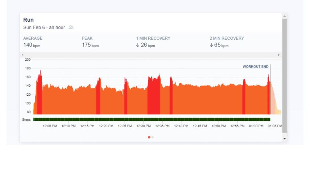

I measured my hr with polar and Charge 5. Polar shows between 135 to 140 Fitbit is total unstable between 80 to 180. I had similar problem also with Charge 4.

hello again,
yesterday i run for 1-h and try to keep my HR under 140.
I measured my HR also with polar verity sense which matched the most of the time with fitbit.
i wear fitbit as explained tighter and two finger from wrist. And make a three pulse restart before session.
However, there are a few issues I'd like to show and expect a slightly more refined answer than last time.
1- in the beginning phase a jump of HR for a few minutes but than normalizing. i though before this is physical phenomenon until i have another watch to doppel chech HR. Sometimes there is a little jump but not more than a few pulse rate(it was very commmon by charge4, and fitst time happening by charge 5)
2- as i reported before the are some spikes again. Yesterday it was 6 times expect of begining jump. duration of this spikes are betweens 1 to 3-4 minutes. As ecpected none of them was detected by polar.
I am sending a picture of my Fitibit HR reading to exemplify it a abit more.
