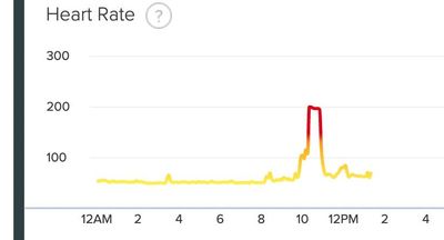

Thanks for getting back to me David. I followed your advice but it made no difference. Here is a screen shot from today

@allan473 Thank you for confirming that you already tried all the troubleshooting steps suggested earlier.
In this case, since you already tried the restart procedure with the charging cable and you continue to experience the same problem, I recommend that you get in touch with the Customer Support team for further assistance with this. They have specialized tools and will let you know how to proceed.
