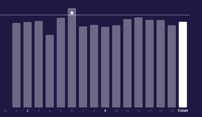

I have noticed that my sleep score has increased in the fitbit app since I started wearing it like this. I assume that's an indication of poor data collection.

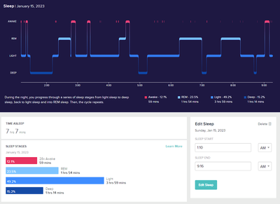

Sleep data for "Today" (worn on tricep)

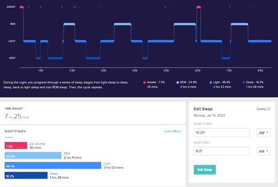

Sleep data for "15" (worn on wrist)

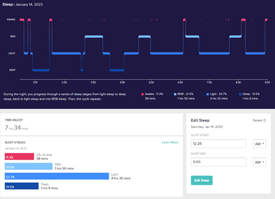

Sleep data for "14" (worn on wrist)
When worn on my tricep, it seems to indicate a lower number of times awake, but the numbers are in general still within range.
