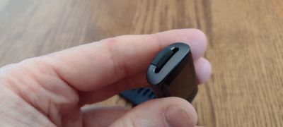

My charge 5 wrist strap also comes off too often, and I'm disappointed by the product. I guess this is probably part of why it has such a steep discount in price so soon after launch.
It feels as if they did not properly test the latch design. I do not think that replacing components will remedy this - a latch redesign is needed. In the meantime, I pretty much expect it to fall of my wrist and be lost for good.
I made a short youtube video demonstrating the latch coming apart (not on my wrist, but the problem happens there too).
Does anyone know if the OE latch mechanism can be removed without damaging the product? Maybe we can make a community replacement with a traditional watch strap spring pin.
Edit: Well, while chatting with customer support I pulled the joint apart a few times to get photos. Now the joint is too loose to actually wear the tracker. I was able to replicate the loose joint with both halves of the infinity band on one side of the tracker, despite the device having an undamaged appearance to my eyes. This seems to indicate that the tracker clasp hardware has a fault. Since I cannot wear the device, I put it back into its box. I guess that solves my concern about losing the device. I couldn't figure out how to shut it off, though. Can anyone tell me if there is a trick to get it to power down? Customer support promised an email response at a later date to help me resolve this, so I guess I'll report back if that happens.
02-19-2022 14:01 - edited 02-19-2022 14:31
As a follow-up, I've been thinking about what could cause the disconnection of the band. I played around with the clasp mechanism and i find it has too much motion perpendicular to the sharp edged catch. I believe it's only supposed to move on it's rotational axis. Because it can move on a translational axis, it can release the band. Maybe the hole clearance around the rotation pin is too large.
I made another video showing this motion:
