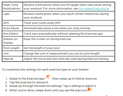

Hi Johny, thanks for taking the time to reply! I had noticed those settings for certain exercises, but not for the one i did (weightlifting). Does this mean this notification feature as not possible for all exercises in the app?

Sorry, but don't know. Sense does include that option for 'Weights'. I would expect it was there on other models also but don't really know.

Ah ok. No the charge 5 does not have that option with weights. It does for ‘workout’ so today i tried to use that activity, but the notifications come in very late, or not all. For example, it will vibrate that i am in cardio zone when i’ve already been in cardio zone for 30-60 sec.
Hoping the customer service can help…
