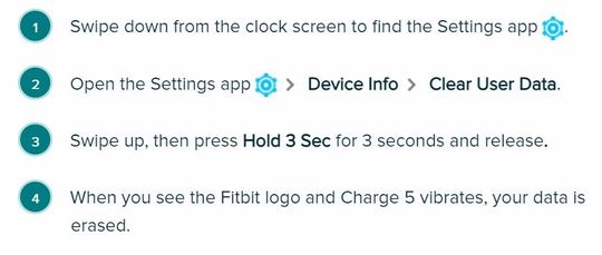

@Wendy2022 I'm sad to hear that your're in trouble with your Charge 5.
Sometimes it's best to do a factory reset if you're experiencing several problems at once.
To do so you should first synchronize your device with the Fitbit app to get your current data safe.
Then go to your account in the Fitbit app and remove your Charge 5.
Now you should make sure that your Charge 5 is attached to the charging adapter before continuing.
Next follow these instructions:
After that your Charge 5 is ready to be set up from start, this time hopefully without any struggle.
I'll keep my fingers crossed. 🤞
