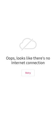

Hi, after updating my fitbit charge 5 app, I'm unable to change the clock face. It always shows looks like no internet connection. I have 5g internet connection enabled also tried with wifi connection. Always shows the same error. Please fix this issue or guide me how to revert to privious version. Screenshot attached.

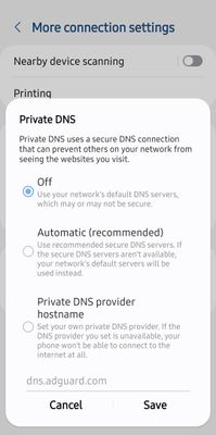

Best AnswerHi @EstuardoFitbit thanks for replying. I have turned off DNS, but still no use. Attaching the screenshot.
I have tried resetting app and device both, changed permission settings and gave permission to everything. Nothing worked. Apart from clock face change everything else works fine.
