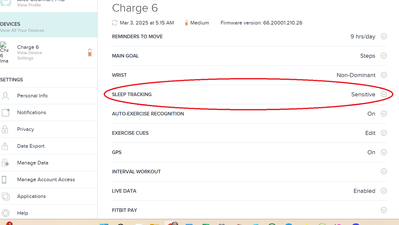

So sorry to hear this! I BOUGHT it for sleep tracking, so I find this problem unacceptable. I went into chat with tech support and got this instruction:
A) Reboot the Charge 6.
B) Make sure heart rate monitoring is on - I accidentally turned mine off - easy to do with a touch screen.
C) If that doesn’t work, go into your settings on the website, click on your device, and set the sleep tracking to “sensitive.” Image attached.
Your settings page is at fitbit.com/settings/device

@RiekoC YES!! YES!! It worked! WHOOT! I'm happy! I've had sleep issues for years - and the current world climate just - well, if I pay attention to any of it, my sleep is such a mess. At 70, I do NOT need to increase my risk of a dementia! I've been very happy with my FitBit - I'm going to have an in-lab sleep study pretty soon and I'm really looking forward to seeing how FitBit does against EEG.

@veryactive - I got it back! My heart rate was turned off - easy to do with a touch screen. I had no idea! Tech support helped me with that.
Look a couple of posts up for my long post with instructions from support. Maybe one of those will help you. Let us know if it worked!
