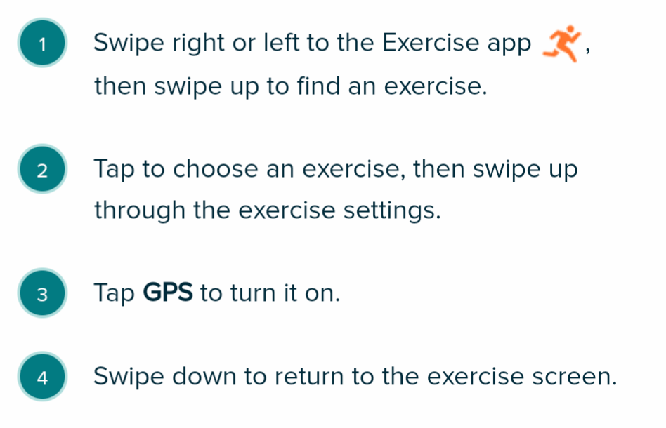

on my old sense 2 when I started and ended a walk I could see a little map of my route in the Fitbit app. I don’t get this when I start a walk on my charge 6? It is sold as having GPS and I have my connected phone on me as well, any reason why?

Oh blimey, you have to do that every walk/run or it remembers your default?

It should remember the setting.

This is a big deal, thanks!
Dang. Was I just inattentive on my Charge 5 or are there a lot more per-exercise options with the 6? Turning GPS on/off, auto-pause, auto-stop, HRZ notifications, etc.

Yep! After my last fitbit update, 3 or 4 days ago, my maps quit showing. Check all the phone settings and they were correct. After your hint I checked my fitbit. Sure enough, it was off. I remember using that setting when I first got the maps working, but easy to forget and not easy to locate on the device. Google doesn't mention it either in the help areas. Big Thanks!

Yes unfortunately it's not the most intuitive UI. When things are hidden away like this it would be best to have a quick animation the first few times showing that the screen can be swiped up.
