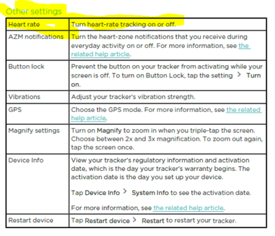

Make sure you don't have heart rate turned off in Settings, though I doubt that would happen on both.
It's definitely on, I've tried turning it off and then back on in hopes of getting it to work.
