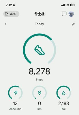

Today I just noticed that the mileage on my fitbit is not being tracked. The device still counts steps just fine, but it says I have walked 0 miles.
Furthermore, if i start and activity such as a walk or run, it says my pace is 0’00”, and the mileage of course remains 0 even if I walk a significant amount.
I have tried turning bluetooth off and back on, fully disconnecting and reconnecting the watch, doing a device restart, etc. Nothing is working.
Any help would be greatly appreciated.
