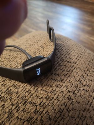

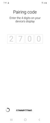

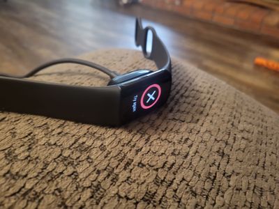

I'm unable to connect my new Charge 6 to my Samsung Flip phone.  It's up to date with Android 13.  The app can see the device and code is sent but it keeps timing out and sending a new code and stuck in an endless loop.  I have done all the tips including but not limited to stopping and starting Bluetooth, restarting phone, forgetting and deleting my old device (Alta HR),  uninstalling and reinstalling Fitbit app, force stopping app and deleting data and cache.
Not sure where to go from here  it's fully charged as can be seen in photos but the loop is endless and it's not connecting.
