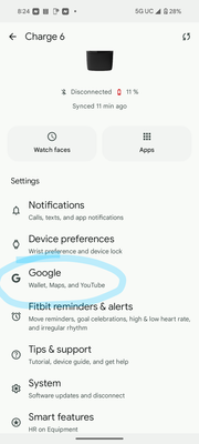

Are you looking in the right place? You won't find wallet under the apps. In Settings, Look under google

Just as I wrote it, the wallet appears in the menu.
I think it might be that I forgot to set the pin after the last reset. And once I've set it up again, just a few minutes later the wallet appeared like in the screen above
