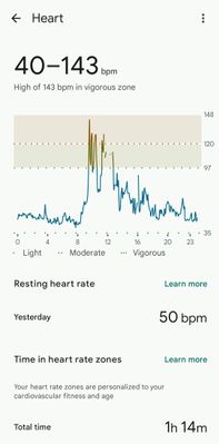

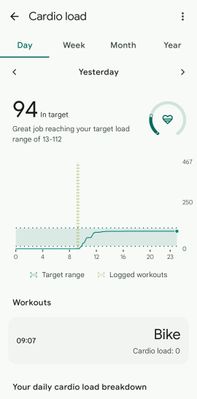

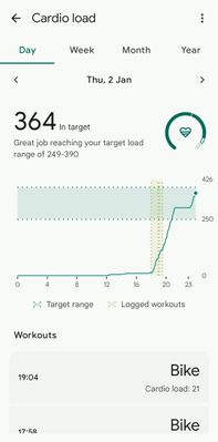

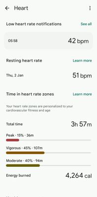

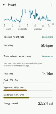

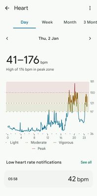

Screenshots are from 2 rides on the same bike in similar conditions on different days
