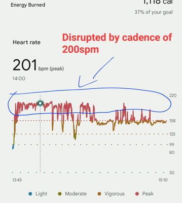

  • HR worst I've ever seen for running on any Fitbit. It picks up my cadence (steps per minute) as HR. Here's example from my today's run:
@CrisVillaFitbit one of those optimizations broke HR 🤷 tried with 3 different Charge 6 and all show the same behaviour when running with high cadence (180spm+).

@Z-Nine this may happen if you run with high cadence. I think one of those optimizations was not filtering out high frequency noise. Older Fitbit suffered from not detecting correctly high HR so now Charge 6 is much better at that but then if I run with cadence 190 to 200spm I "thinks" it's just high HR and doesn't filter it out. I run nearly with perfect rythm so most likely it mistakes it for HR. This will mostly happen to athlete-level runners. For me, the only way to get that working is changing way I run and that's not gonna happen. Won't compromise technique and form for the tracker.

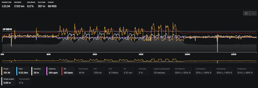

Just to picture my running technique (trail hill repeats workout, 6x long hill, 4x short with steep 16% finish), here's data from Stryd footpod. Charge 6 got HR spot on this one (doesn't happen often but it does 🤷) but distance and all other metrics are horribly wrong (GPS worked here, too, no broken waypoints in the TCX).
White is a stride length that closely follows pace (pace in my case depends on stride length as cadence is nearly constant, this is well visible here as pace and stride length are nearly overlapping). Regardless of the elevation grade and intensity, I keep my cadence at target (with some exceptions when it's more natural to increase it, ie. steep downhills).

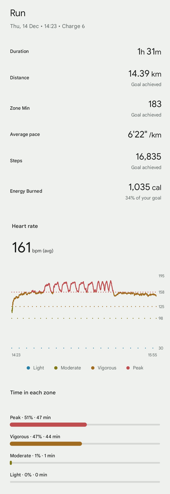

Fitbit Charge 6 recorded this:
I'm happy the HR worked for once but look at the distance! 17.02km vs 14.39km. It's such a huge error that makes Charge 6 totally unfit for running. Another thing worth noticing is that it undercounts steps at the higher cadence I run (I did a few tests to confirm it). It says 16835 steps here. So let's count. The Stryd is a footpod so it counts actual steps (worn on my shoe). From cadence and time, I can get the real number of steps which is (for 91 minutes) 17645 steps. That may be responsible for cutting my distances short (another optimization? filtering out high-frequency steps? have no idea). One thing I need to remember is that these are hills and Stryd gives me 3D distance (which will be higher on the incline/decline than on a flat surface for the same horizontal distance) but that wouldn't account for over 2.5km difference. No way.

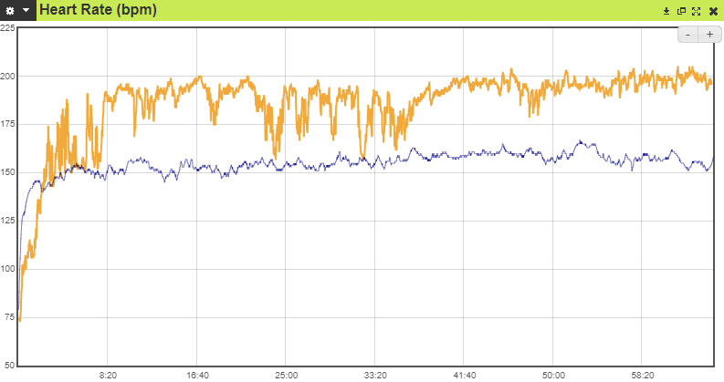

And today's steady run. Comparing chest strap HR (blue) and Charge 6 (orange), the cadence of 195spm:
If Fitbit wanted to fix it they could probably get any skilled runner to reproduce the issue (it's dead easy, happens almost every single run).
