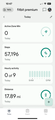

Same thing happenned to me this morning, apparently I walked over 29,000 steps in my sleep at midnight. 20 minutes later, that count had jumped to over 57,000 steps. There is no way that any amount of rolling over in my sleep could generate that kind of count. According to fitbit, that is over 17 miles I logged in my sleep between midnight and 1AM. Seriously? updated to include photo

On your app, click on the icon in the upper left hand corner and check connected devices. If your iphone is connected, remove it. This should solve the issue. Found the answer on another thread, it was provided by @JohnnyRow.
