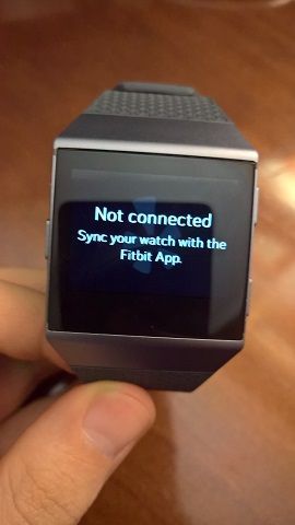

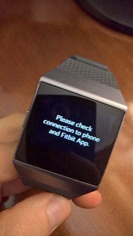

I've been experiencing issues with the Ionic apps from the App Gallery that require Internet conectivity to work.
I believe these issues might be caused by the Fitbit Windows app, as they don't occur when linked to an iPhone.
When opening apps like Yelp or CCMarket on the Ionic, an error is shown asking to check connection to the phone app.
Could anyone with an Ionic and Windows phone please confirm if they are also experiencing this issue with those Apps?
I use a Lumia 950, which is on the list of official supported devices.
When opening apps like Yelp, Stocks, or CCMarket on the Ionic, an error is shown asking to check connection to the phone app.
I've tried with both a Lumia 950 and Lumia 550, which are on the list of official supported devices.

@jimm98y Have you tried other apps such as the Yelp or CCMarket apps that obtain real-time data from the Internet? Do you receive the same errors shown in my pictures?
Thanks!

Hi all.
@JMC94 @Michael I can confirm that apps like Yelp, Stocks, or CCMarket require Ionic to sync with your mobile device before statistics from these apps will be displayed on the watch.
Just to confirm, are you still seeing this screen after you have successfully synced Ionic to your Windows phone?
@jimm98y I believe the experience you are describing is separate from what others have posted in this thread. We are currently investigating reports similar to yours and are working to have this issue resolved in a future update.
Let me know if you have any questions!
