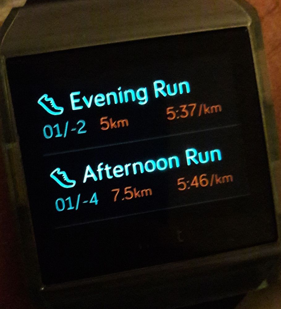

I am having the same problems. The runs in the photo are of today and december 26

@Iljaverweij exactly the same dates I'm getting too. weird, The fitbit and strava apps on Ph show correct dates and times though. Hope they find a solution soon.

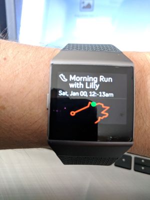

I have the same issue over the past 2 runs. Hopefully this doesn't continue beyond Jan 1 or that FitBit or Strava can find a way to correct the issue. 12:-13AM??

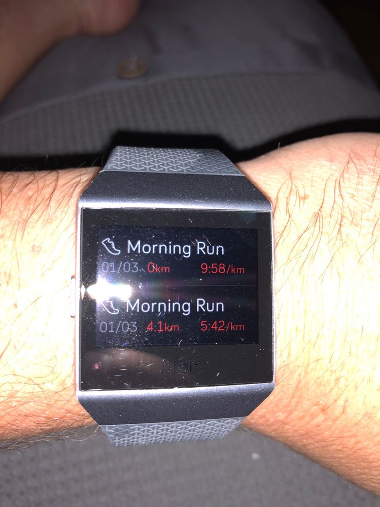

Looks like it fixed itself
