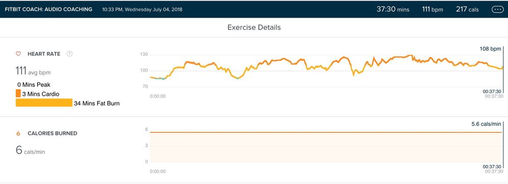

Couldn't agree more! How can the "Premium" service by FITBIT themselves not use the actual device I bought to track the Coach App workouts? This seems crazy to me.
Like yourself, I have been pleased with the Charge 2 HR and thought, "Ok, let's up the game" so paid £32 for a year's subscription to then find out it doesn't even pull the data from my charge 2 to give me an accurate calorie burn and therefor motivation.
I'd go as far to say that it is very, misleading to customers to say "Upgrade to Premium" to find the premium option doesn't use the tracker you paid all that hard earned cash for.
07-04-2018 15:56
07-04-2018 15:56
@SunsetRunner wrote:Couldn't agree more! How can the "Premium" service by FITBIT themselves not use the actual device I bought to track the Coach App workouts? This seems crazy to me.
Look at the calorie burn graph for the Coach Session. That is pretty useless. Bitterly disappointed.

It's great to see new faces @SunsetRunner, welcome!
I really appreciate the feedback provided about this topic and recommend taking a look at the Integrate heartrate data into Fitbit Coach calories burned request, vote for it and leave your comment.
