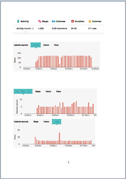

I'm in continual dialogue with Fitbit because I firmly believe there is an error in the VAM algorithm.  The following graph shows that when you compare my constant steps and I need a minimum of 7 calories for one minute of VAM and in this case I only received 8 minutes from 38 minutes.
If I walk at 4.0+mph I get about 50% VAM but the total calories divided by time in minutes would give me 100% VAM. When I walk faster I get more 8, 9 and 10 calorie spikes
with many 6 calorie spikes. The total of these recently on a 53 minute walk exceeded 420 calories which divided by the 53 minutes would give me an average of 8 calories/minute rounded.
The steps and pace were consistent therefore there should not have been the spikes.

What you have observed is the other issue. If the total calories for the activity are not greater than your minutes for the activity, multiplied by the calories for 1 x VAM minute, the graph you see for your calories gets flattened out, no peaks and it is seen as lower activity than VAM.
You need to establish how many calories are in 1 x VAM minute. In your case you can do that by examining the Dashboard VAM before and after the manual activity giving your the difference. Then,deleting the activity, counting the peaks that should equal the VAM difference, and those with the lowest calories should be your minimum calories for 1 x VAM minute.
If you look at the 6th picture in the Fitbit Profile, I created some simple manual activities to establish what my active minutes "break points" were. I had better update that for the new calculations and changes in activity type, but when looking at your profile graphs these colours are still relevant.
On the new active minutes, the graph in my pictures is still current for the number of calories/5 minutes except RED has become GREEN, YELLOW remains, and BLUE became RED and they have eliminated sedentary and included it with RED.

@cand3laYou are doing nothing wrong. I have reported this oddity to Support when my Ultra and One gave me similar results. The embedded graph shows you my results where I received 26 minutes of VAM out of 53 minutes (any spike of 7 calories and above = 1 x VAM), but if I manually apply the total calories of 373 to the 53 minutes I would get 100% VAM.  I need 34 calories/5 minutes to achieve 5 x VAM.
You will notice the steps are very constant and this was walking on flat pavement with no gradients.

I'm coming around to thinking there is a "bounce" effect with the Fitbit's. I say this because a few weeks ago I had 100% VAM and I had to research it. The 3D accelerometer within Fitbit
Part of my lower back exercises is now sitting on an exercise ball and bouncing at about 100 steps/minute (as recorded by Fitbit) for core strength.  100% VAM and more calories than me walking at 4.5 kmh. Hence the bounce effect.
