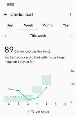

I'm convinced this new (ish) cardio load feature is daft. I mean, what does it even mean? Some weeks I exercise every day and it tells me I'm 'in danger of under exercising" and other weeks I sit too much due to work or menopausal fatigue and it tells me to "take it easy'!
Furthermore, if you log an activity that never seems to get taken into consideration, so it's like you never did it as far as 'cardio load' is concerned. I'm told this is linked to 'daily readiness' but no idea what that is either. Gimmicks?

This help page (<-- click) provides more information on Cardio Load & Cardio Target Load, including how the values are calculated. This page (<-- click) explains the Daily Readiness Score & how it is calculated.
These are recommendations that you are free to follow or ignore. There are plenty of days that I ignore the target load, especially when I'm not feeling well.
One of the things I have come to understand is that Fitbit measures CARDIO metrics.  Things like Cardio Load, Zone Minutes, and Readiness are calculations based on your heart and lungs.  They do not take into account muscle fatigue and recovery.  Those you have to judge for yourself.  If your body is telling you that you need to rest, believe it.  Cardio metrics aren't likely to pick it up

Based on your post, it looks to me that you are confusing Active Zone Minutes and Cardio Load. It's the Active Zone Minutes goal for 150 minutes moderate exercise or 75 minutes of vigorous exercise per week, which is in line with the World Health Organization's recommendation for adults.
Since you switched your Cardio Load fitness goal to Maintain, you should see a more reasonable target range. Keep in mind that even the Target range is a suggestion. Listen to your body and how you feel.
Personally, I look at the Your past 7 days training bar graph to see where my dot is. If it's in the Maintain section, I don't stress out when my Cardio Load is less than the Target range. I also check my Cardio Fitness score on the Heart page. As long as it's in the Excellent range, I'm comfortable with where I'm at.

Cardio Load is a lot like Zone Minutes but more accurate.  Zone Minutes only has 2 values.  1 point per minute for moderate exercise and 2 points per minute for vigorous or peak exercise..
Cardio Load is a continuous scale.  The harder you work, the more points you get.  The formula is minutes x %HRR x 0.65 x e^(1.95 x %HRR).
When you compare the two, you get more points from Zone Minutes at lower heart rates and more points from Cardio Load at higher heart rates.  The cross over is at about 70% HRR which is about where you enter the Anaerobic Threshold.  Since the Cardio Load calculation is exponential, it kind of takes off after that.
