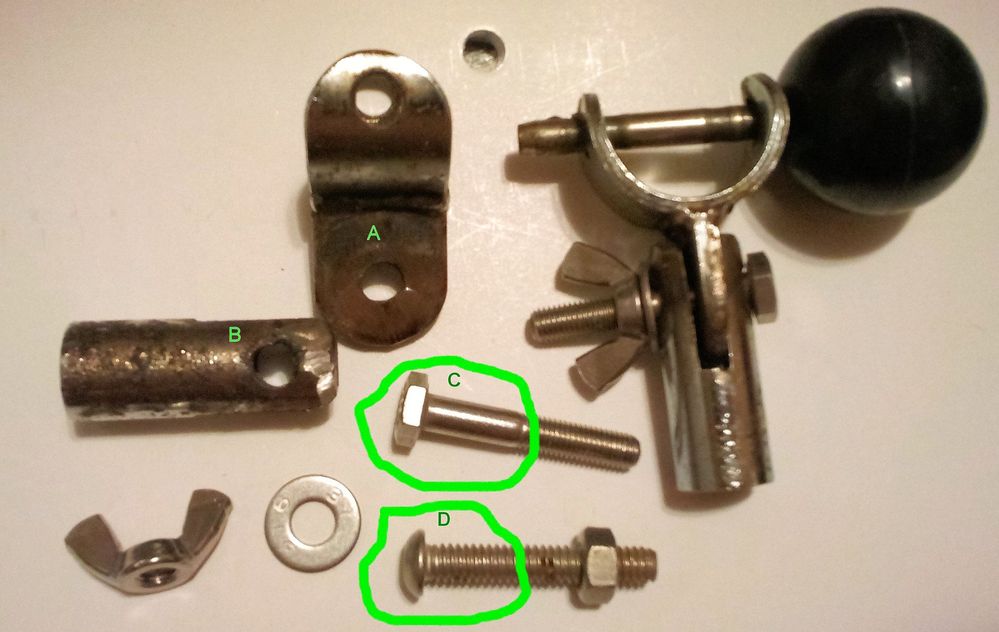

Due to age/wear & tear, the bolt holes in my rower's oar connectors were enlarged and ready to break.
DP BodyTone 300 oar connectors
That part is no longer made, nor available at hardware or auto parts stores. I found a local repair shop that was willing to refill those holes (by welding) and re-drill the proper-sized holes for around $20!

Repaired oar connectors...
A previous owner used a fully threaded bolt (D).
Those threads acted like a saw or file and almost completely tore through holes (A) & (B).
A local welder weld-filled those holes and re-drilled the correct ones, all for $10!
A partially threaded bolt (C) should keep that from happening again.
