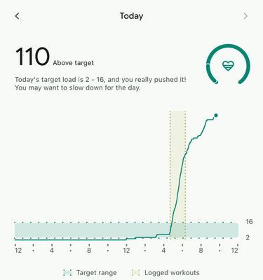

I’m so glad you posted this- very reassuring. My target today was…. 2-16…
needless to say, I guess I’m just going to overtrain.
