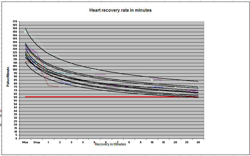

When I started using a HRM many years ago I was interested in the Recovery Heart Rate (RHR) and as I have aged it is quite interesting the graphs gradients of RHR have kept the same even though my maxHR has dropped through the years. My resting HR is 60 in this graph but again as I'm typing now it is 57 bpm and can get down to 42 bpm when I'm asleep. Just my genetics... Here is another link

Ok Colin, someone that likes tracking data as much as me it appears! ![]()
My Garmin only shows the HRR for 2 min time span, on pop-up window, but not saved with data.
Had previous HRM that let you select 1 or 2 min time span, and it saved with the data, but couldn't upload any of the data, so had to record it elsewhere, and I usually didn't.
I still don't record it, because usually a jog ends with 5 min walk, so the drop is minor, or the bike I stop the workout and slowly come in stretching and such, so another unfair view.
It is interesting view of fitness level though, even better than resting HR in some ways.
