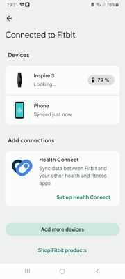

Thank you @ManuFitbit @ No idea if I have mobile track! Tried following instructions, but don't have 3 dots or unpair
Don't want to muck everything up!
Never had this discrepancy in 6 years of using fitbit, using this phone for last 2 years.

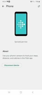

Best Answer09-11-2024 12:09
09-11-2024 12:09
@ManuFitbit took the plunge and disconnected my phone, no idea why it suddenly started counting steps itself, and have sorted it, I think, at least today's readings are identical. Can't remember the old results, just that they were out by varying amounts each day
