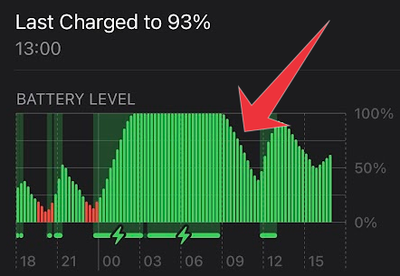

I recently got a Fitbit Inspire 3 (version 20001.188.58). After a couple of days of usage, I noticed that the battery life of my iPhone X (iOS 13) had shortened considerably. After a full charge, the battery would have fallen to 50% after only two hours. See the image below:

You can see the much slower reduction in the battery below, where it went from a full charge to 50% after 13 hours.
This excessive battery usage can also be seen in the graph below, which shows the battery usage of the phone over 10 days:

Some good news! I appear to have resolved the battery issue. I reinstalled the Fitbit app. I noticed that I had three devices linked to my account: the Fitbit Inspire, and two old Aria Bluetooth weighing scales that didn’t work anymore. I wasn’t able to remove them from the app, but when I logged into my dashboard on this website, I was able to do it from there. While I was logged in, I also disabled GPS tracking on the Inspire. These changes appeared to have reduced my battery use back to the way it was before I installed the app, which is great 😊
