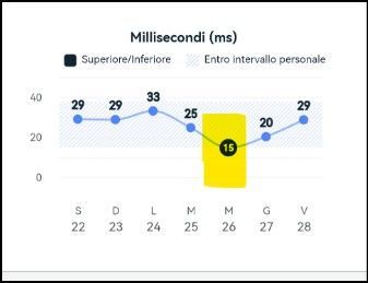

Now, pragmatically speaking, how can we utilize at best the data provided by Fitbit. It was easy to ascertain that the Inspire3 measures HR accurately enough, even in non-resting states like jogging on a treadmill hands free (up to 140 bpm in my case).
So, the night HRV parameter is not a garbage-in, garbage-out situation. It has its meaning even if it cannot be directly related to other HRV metrics.
I would suggest technical assistance to provide statistical data on Fitbit HRV values for different age brackets in different ages, as other labs are doing, so that we can locate ourselves in terms of percentiles and decide if we look statistically low or high in this specific HRV score. This would avoid the confusion and concern caused by different apps providing non-comparable scores in the same time-unit (milliseconds). A very tricky situations.
Another useful concept is that the trend may govern and not just the score itself. The other night I was sick. The Inspire3 HRV score correctly picked this anomaly by a dip in nightly HRV. I don't know if this is due to the sleep interruption of about 1.5 hours or to the HRV fluctuation itself, the dip was there though, as it was a higher-than-usual nightly average HR.
This is a snapshot of the plot, sorry the Italian language, the image speaks for itself though.

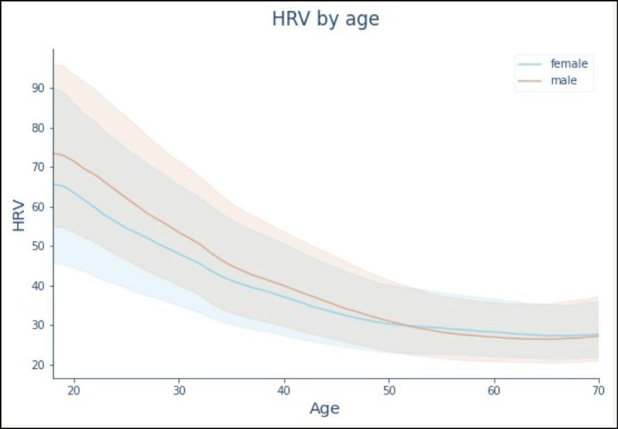

Best Answer08-01-2023 12:26
08-01-2023 12:26
This is an interesting plot to compare the median HRVs of males and females of all ages. Source the Oura Ring website. It is not specified what the color fields are, probably variability in percentiles (5th to 95th? 10th to 90th? 0th to 100th?)
