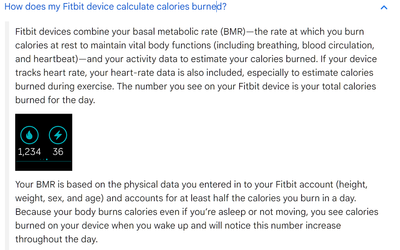

Sorry, guess I should have included how to find 'Settings" and "Quick Settings" in my response above, but apparently you did get this info from customer support. I guess I was assuming you would already be familiar with these on your device.
You might want to take a look at this link for more info on the Inspire 3, including a link to the Inspire 3 user manual.
https://support.google.com/fitbit/answer/14237921?hl=en&sjid=2289721677656949616-NA
