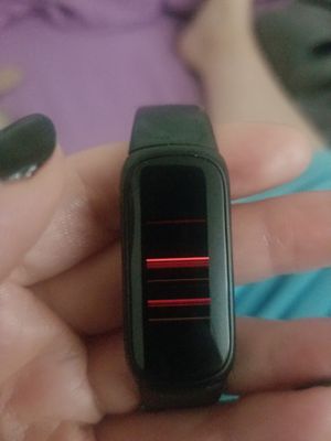

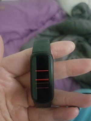

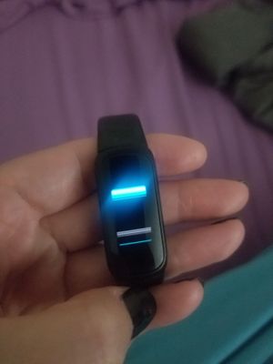

This morning I woke to my Inspire 3 fitbit's screen glitching. It was working great before I went to bed. I am unable to restart it from the Fitbit as all it shows is different lines through the screen when I scroll through it. Nothing changes when I charge it or change the clock face. I've attached a photo for reference. Every screen it shows when I scroll through it is just a bunch of different coloured lines

This morning I woke to my Inspire 3 fitbit's screen glitching. It was working great before I went to bed. I am unable to restart it from the Fitbit as all it shows is different lines through the screen when I scroll through it. Nothing changes when I charge it or change the clock face. I've attached a photo for reference. Every screen it shows when I scroll through it is just a bunch of different coloured lines.

Hi, @Kayrachelle , as your screen is not working properly you will need to try the alternative restart procedure for your Inspire 3. Please plug your Inspire 3 into to charge using the supplied cable and a charger known to be working. While it is plugged in and charging, press and hold the sides of the Fitbit for at least 10 seconds. When your device restarts you should see the Fitbit logo and the screen restored.
Once you have given it a restart, if the screen remains as you have shown, you could try the clock face change again, which you do in the app. Full instructions are here . Hopefully with these two steps everything will be back to working properly again, but if you continue to have problems you can get in touch with Fitbit Customer Support on Contact.fitbit.com and they will take it from there.
