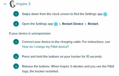

I just realized you haven't mentioned trying a restart .
That's the only suggestion I have.
If that doesn't work, all I can suggest is contacting support or waiting to see if someone else has a better idea, but the restart might do it. I've been watching these boards for several years and don't recall seeing a case like this before with any model. Thanks for providing all the info I have asked for.

I did try restarting it too. I even deleted my account and the set up to the Fitbit and removed the app from my phone. It didn't seem to make any difference.
