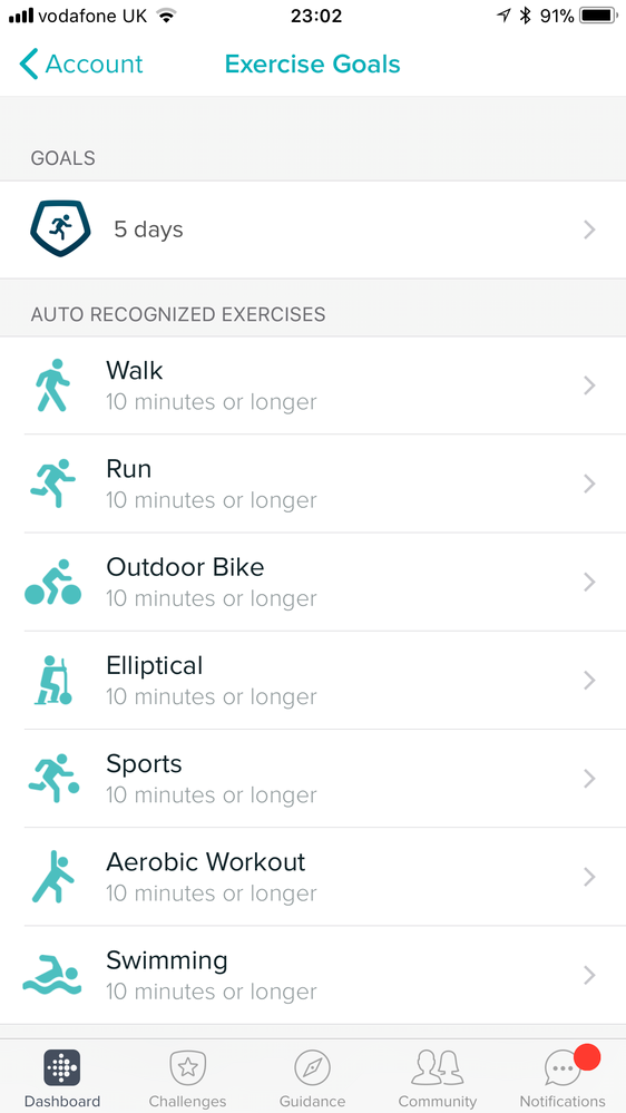

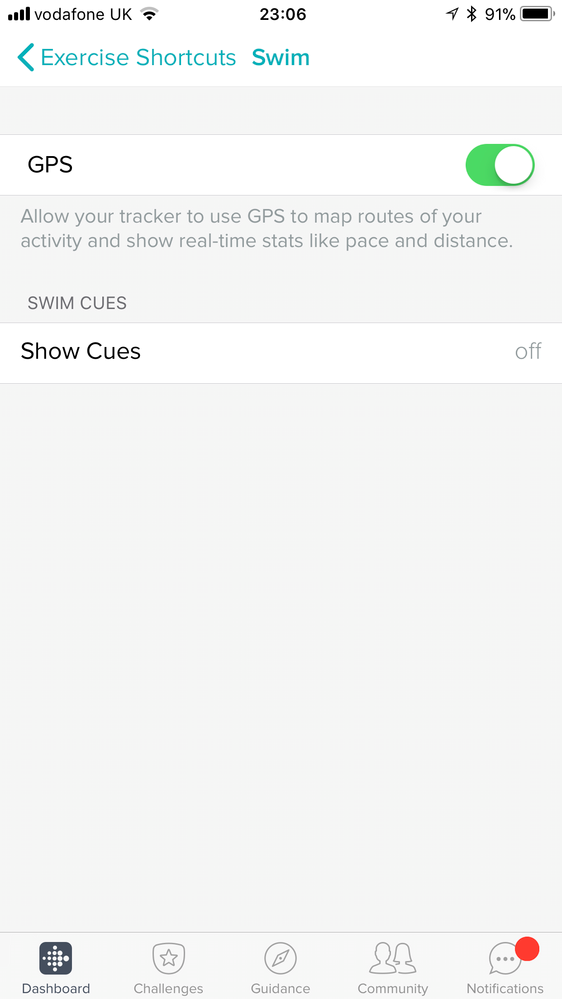

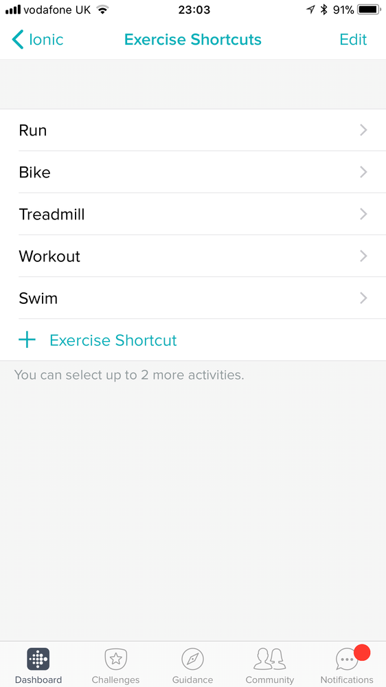

Still no luck. These are my exercise areas. Can’t see a gear though? It doesn’t seem to auto recognise swimming either so I’m stuffed at the moment.
Claire
@alrightpoppets Now on your Ionic swipe to Exercise and tap on Swim. Then tap on the little gear icon at the top left of the Ionic screen to access swim settings.
