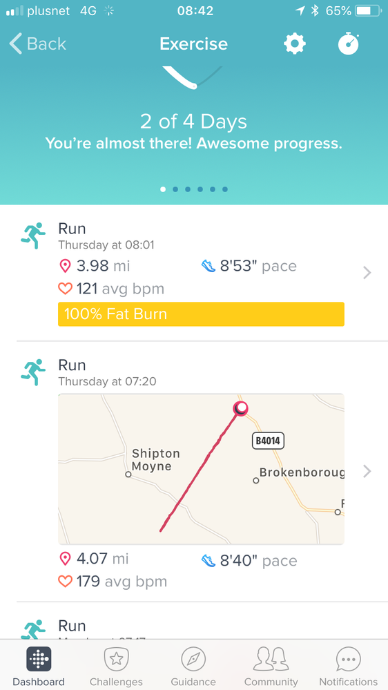

Best AnswerIs it adding a second activity or run?? I've found over the last 2 weeks when logging a run or walk it is adding a second run or walk and adding extra steps. I have to delete the extra activity to get my steps back to what they should be
I’m having this issue too! It happened yesterday so how do I know which version I’m on? Mine adds duplicates
Best AnswerGo into the Ionic settings on the Fitbit app - check if the firmware is 32.10.20. If so, you have OS 2.1.1
Best AnswerAhh it got me again!! So strange
