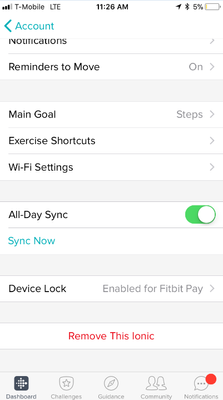

As well as clicking the radio button, have you force synced the changes through to the Ionic before leaving the settings page. Can’t remember off the top of my head but isn’t there a sync button at the top or bottom of the page? (I have temporarily removed the Ionic from my account, so can’t check out the exact procedure at the moment)

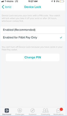

You can either deactivate the pin or set it to Fitbit pay only by going into the App and pressing the device lock option at the bottom of the page. once that is pressed you will see the two option enable or use for Fitbit pay only and once you press the feature you want it will sync the watch and you should be good to go.

As @rfjouben stated, please go to the app
- Go to Ionic Settings
- Device Lock
- Select Enabled for Fitbit Pay Only
This should only prompt your pin when accessing the fitbit pay.
