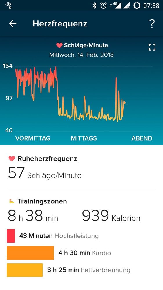

My Ionic even records hr while sitting on the table during the night. This totally destroys the data.
