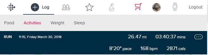

@Crypticwritin
I finished my training run this afternoon and have reviewed results:
In 3 hours, forty minutes, Ionic battery went from 100% to 67%. In my opinion, that's pretty good.

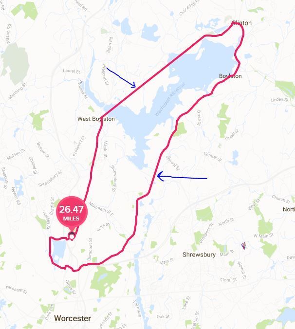

However...
for two separate periods in that time GPS connection was lost. When that happens you get unpredictable pace and distance cues and results. Here's how the mapping appears, the lost connection times are represented as straight lines (over water, buildings, through forests):
Ionic almost always loses GPS connection after 8 to 10 miles. Sometimes the exercise just crashes.
Fitbit seems to recognise these risks and doesn't use GPS to calculate pace and distance. Visit the 'GPS Inaccuracies' thread for a full dramatic treatment of this topic. In short, the Ionic uses stride-length and step count to calculate pace and distance.
When you're in a race, the Ionic is at its worst: the faster you run (with longer stride length, fewer steps) the slower it thinks you're going. In a 5K race, Ionic usually measures distance at 2.2 to 2.5 miles.
This has been true for both my original and replacement Ionics.
To buffer against all that nonsense I also run with my fitbit Surge (or leave Ionic in the locker). It doesn't lose connection and appears to use GPS to calculate distance and pace. It actually measured today's run at 26.2 miles (as I'd pre-planned using google maps). Plus it didn't show me running over the reservoir.
I don't know what level of performance you're expecting from your Ionic. If nothing else it seems to clock elapsed time correctly as well as step count. Heart rate is another matter, handled at great length in other topics.
Good Luck!
