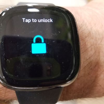

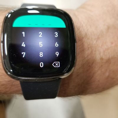

How can I tell if my Fitbit is lock
If you open the screen of the ionic and you see this.
Or
Your Ionic is locked.
Basically if you cant get ti anything on the tracker without entering a pass code, it is locked.
The problem comes when the code is entered incorrectly to many times and you get the message to unlock with phone.
